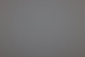

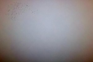

I've been shooting digital Canons (EOS-1Ds Mk I II III, EOS M, R, R5) from 2002-now and for the first time I have a dirty sensor.
Following the manual instructions on page 782 isn't making a dent in it.
All the dirt is in one corner so I fear I must have touched it :-(
So page 783 says in this case take it to a Canon Service Sensor.
Questions:
1) do you believe them? Is anyone cleaning the sensor manually?
2) how much is this going to cost me?
Here's the unphotoshopped version, and a version with contrast cranked way up.

I have the Visible Dust Arctic Butterfly 724 Super Bright and a Visible Dust loupe (an older model they don't sell any more), and that's always been sufficient for cleaning. I also have the Dust-Aid Sensor Stamp and a LensPen SensorKlear (the other products used by Lensrentals), but I've never needed to use them.
I have no idea what Canon charges to clean the sensor, I've never had them do it (though they did it for free with my 1D X when they did the shutter recall service). The Arctic Butterfly is not cheap, and if you get just that and the loupe it may cost more than paying Canon. But it's not hard to DIY, and over time it will likely be the cheaper option.
I'd at least try a wet cleaning ,maybe even a second one, before sending the camera to Canon.
If you strictly follow the swab manufacturer's instructions - FULLY loaded battery - not too much liquid or pressure - nothing can go wrong.
I've done it several times with Leicas, which don't have "sensor cleaning" like Canon. In 8 Canon years, never had to clean a sensor. Strange?
Be careful with pressure, the sensor is suspended on the IBIS cradle, not fixed like older cameras.
I’ve only had to clean my R5 sensor once so far, and it turned out to be a big grease spot on the RF100L back element!
My first step is visual inspection, followed by brushing with a sensor brush and blowing it out with a rocket blower. If that doesn’t help the swabs and fluid will have to get involved.
The shutter curtain keeps out a lot of dirt and debris, so I’m keeping a close eye on my R8, which lacks that feature. The R8 does run the ultrasonic cleaning when removing and attaching a lens, even when powered off. And the manual says to power off the camera when changing lenses :)

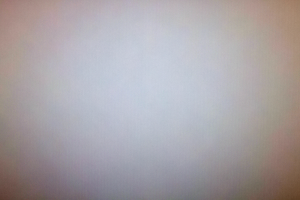

Thanks again for all the help. The Canon Service Center in Tokyo's high-end shopping district Ginza was just 25 minutes from home, just a few meters from Higashi-Ginza exit A8. Second floor reception area had seating for 20+ but just a couple waiting at 1PM. Although they do service while-you-wait, it apparently does require a reservation. They had a cancellation and could service my camera at 4PM for a 5PM pickup but my other errands in Ginza would only take a few hours so I just dropped the camera off and told them to send it to me--about $7 overnight via Yamato. Camera came back today.
Most important thing of course is that they cleaned the sensor. There's no commentary as to what it was but the shape to me was clearly a fingerprint. The camera and the lens I had them clean (24-105, my first RF lens) looks basically new, but it wasn't that dirty anyway.
This image is an L JPG with min and max image levels adjusted to 0 and 255. I don't know if the stripes are a JPG artifact or a sensor feature or due to shooting a white LCD out of focus. I suppose I should do a deep dive into figuring that out and also finding how much lower the "peripheral illumination" correction is at lower ISO, but not my priority today. The spots are gone, which was my main interest.
Try shooting at f/11 or narrower, that really starts showing spots on the sensor.
The vignetting certainly suggest the lens is not stopped down much, if at all. Wide apertures don't show sensor dust. Basic stuff.
@SwissFrank – shoot a blank white wall with even illumination or the clear, blue sky. Use a focal length from 24-35mm and stop the lens down as far as it will go. That's how to check for sensor cleanliness.
