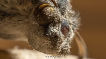

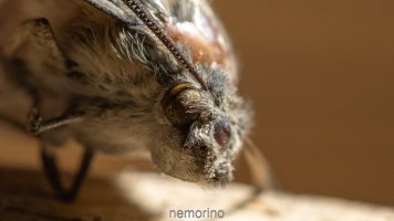

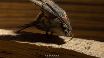

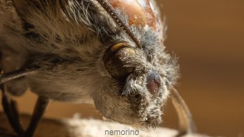

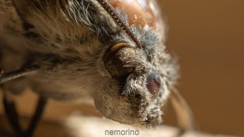

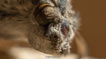

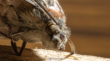

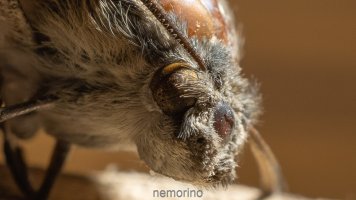

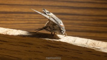

There is a lot of talk about focus shift of the RF 100L macro. I have used the lens without any issues and have been wondering a long time what's that talk is about.

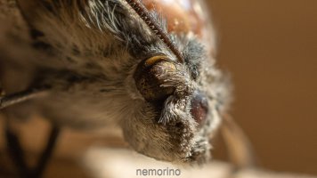

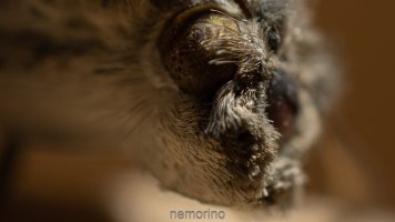

So I have made four series of pictures with changing aperture.
Subject is a dead hummingbird moth I found and which is pefect for a "real life" test.
I put the camera on a tripod with a macro rail to focus, connected it to my PC. Focus set to manual, IS off.
Electronic shutter and 10s delay to prevent shake. After focussing I didn't touch the camera and set everything via PC.
The focus is set on the eye like in real life by using the 15x preview.

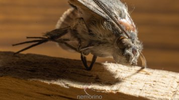

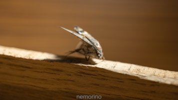

For every magnification I first post the uncropped picture at f/2.8 and f/32.
First 1:1.4 or better mfd

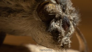

And 1:1 crops 2758x1551

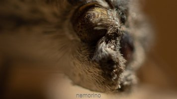

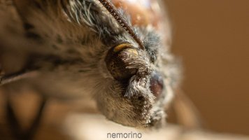

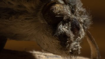

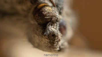

f/2.8

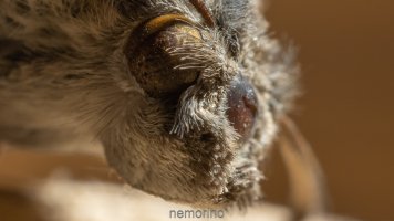

f/4

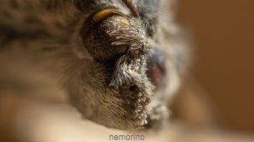

f/5.6
f/8

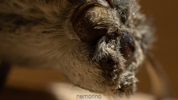

f/11

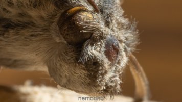

f/16
f/22
f/32
The DLA of the R5 is f/7.1 so @ f/8 und higher thegeneral sharpness decreases but still the eye is the most sharp subject. I see no focus shift issue.

But on my posted pictures the hairs in front of the eye get sharper the tighter the aperture is. So the issue is to small to be seen in "normal" use. I have about 9000 pictures shot last year with an aperture tighter f/8 and the RF 100L macro and have not noticed it.
