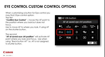

I have read all the sections you mentioned and already set up back buttons for different focus scenarios and using them very efficiently but incorporating eye controlled auto focus with them seems to bit more tricky/requiring bit more homework. I tried a few set ups but can't seem to get the eye controlled autofocus working properly for the time being, will keep on working on it. Thanks for input, you have been very helpful.Custom button options:
Canon : Product Manual : EOS R1 : Control Customization Details
cam.start.canon
Eye control section:
Canon : Product Manual : EOS R1 : Using Eye Control
cam.start.canon
There are plenty of options for turning on and off various aspects of eye control, using a regular button or the special AF button.
That section does not cover eye controlled autofocus, I've been thru the chapter that has eye controlled autofocus but still can not get it working properly with my back button focus settings. It is working but not exactly picking up where I am looking, may be need to do calibration again. I might also have to change how I set up my back button focusing to suit eye controlled auto focus. I am using 3 back buttons for back button focusing at the moment. Thanks for your input.You are correct, it was for the R3.
