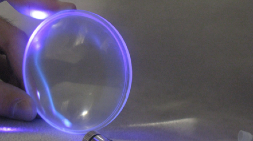

Originally, Polycarbonate and Acrylic have been used in Eyeglasses/Sunglasses production.
Further information about such uses is below:
but for computer and video imaging application LITTLE has been done except in Infrared (thermal) imaging applications for reasons outlines below which are an illustration of the TRADITIONAL PROBLEMS of using polymer lenses in video, still photo and telescope applications:
Lens Power and Chromatic Aberration:
HOWEVER, today in 2020 it actually IS POSSIBLE to make a typical still photo and video-centric optical lens for use on consumer and professional grade video and still photo cameras since much research and NEW FIXES for those traditional manufacturing and coating issues is now available from such places as GS Optics, Edmunds Scientific and many others:
Plastic Lenses REQUIRE anti-scratch coatings:
Good Technical Book to Read:
Handbook of Optomechanical Engineering
If you want to BUY Molded Acrylic Aspheric lenses:
For Short Wave Infrared Imaging purposes someone has decided PLASTIC LENSES are good enough!
Antireflection Coatings Make Plastic Lenses “Disappear”
Precision CNC Machining Polymer Lenses:
The key part is while there is ACTIVE RESEARCH into cinema camera-grade optics, there is NOT YET a viable product being sold in the general marketplace. However, if Canon OR Sigma wish to do so, it is EASILY done by their optics teams who DO HAVE the technical expertise to make FAST lenses made of polycarbonate and/or acrylic happen!
