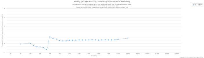

Visual comparisons like the DPR comparison tool or the digital picture one are presented as RBG render (compressed to jpeg). DxOMark and photonstophotos work with raw files. Dynamic range requires knowing the noise floor and you need raw files for that.

The topic is about the 'sensor performance'.
What you describe above is the comparison of software, not sensor performance.
