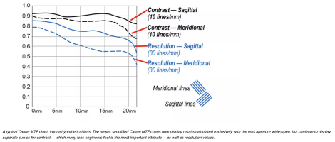

Without a legend of what each MTF graph shows, it isn't straight forward to compare them.
You have given a link to Nikon MTF charts so no wonder you have problems. Canon has the relevant information on Canon MTF charts. Try googling how to interpret Canon MTF charts and you will find what you want.
https://support.usa.canon.com/kb/s/article/ART152319#:~:text=MTF charts display the lens,is about 21.5mm away.
That's part of the answer, thank you. The part that's missing is the mapping of "F/8" and "F/max" to colors and so forth. It's an explanation but not a legend. To be able to meaningful comparisons between MTF graphs you need the legends included. Or why do some MTF graphs have more lines than others? That link above doesn't say.
@David_B please note the spelling of the word sagittal, which Canon spells correctly but you managed to mangle the first time and misspell the second time.
And you were needlessly rude, but hey, that's nothing new for you, is it? I was beginning to think you'd turned a new page but obviously not.
But that's only 4 lines, some Canon graphs have 8. We're getting closed to having a full understanding of MTF graph values, it is a shame vendors make it so difficult.
You supplied the link, I only followed it. I hope your experience with the link you provided was better than mine.
Just type “Canon MTF charts“ into the search bar of your favorite search engine. One of the first few links will be to a canon site that explains all of this. Maybe that’s too challenging, and I had the page open anyway.
Regarding the number of lines, one of the things you might read in that site states:
Canon MTF charts will now only display MTF results at the lens’ widest maximum aperture — previous Canon MTF charts displayed results at both maximum aperture, and at an effective f/8
