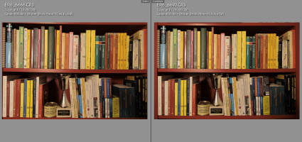

Some details and highlights; EF 24-70 f2.8 II L USM always on the left, RF 28-70 f2.8 IS STM always on the right
The RF in raw looks wider then the EF; the latter was framed at the edge of the books, but the RF shows a nice extra chunk of the library frame

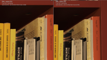

28mm top right extreme corner, where the EF seems clearly better then the RF

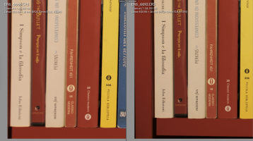

But on the opposite side, bottom extreme left corner, the RF is way better then the EF; so I would say that camera orientation was not 100% matching between the two sessions, and that the RF may also be pretty sharp in the extreme corners and borders if properly focussed. So I will actually call it even, the EF has not a real field relevant advantage over the RF even in the extreme corners, if the plane of focus is correct

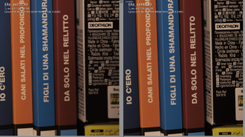

This is 50mm bottom right extreme corner and border, it's the focal length where the RF majorly outperforms the EF in the extremes, and that's an all 4 corners and borders; the "DZA" on green in the super extreme last millimetres of the corner seems like central sharpness compared to the EF performance

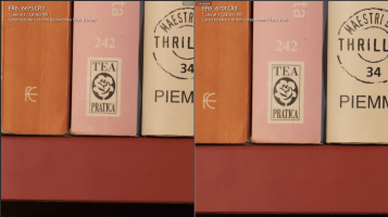

Lastly the 70mm central sharpness, both wide open; the RF clearly shows the print reticle on the pink and orange books, and also on the red library frame the micro detail is crisp and sharp, while the books on the EF look like solid colours, without print details. The EF if stopped down to f5.6 slightly surpass the RF at f2.8 in terms of contrast, but the micro detail of the RF wide open is still better and crisper then the EF at 5.6 so the RF (on a 20mpx sensor) seems to resolve much more finer lines then the EF.
