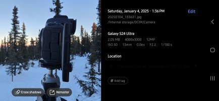

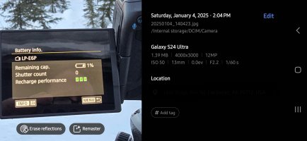

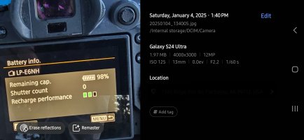

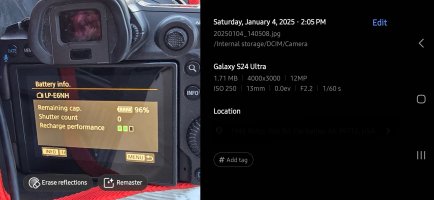

I just received my mark2 back today and did a R5m1 vs R5m2 test. I set both cameras up outside with fully charged batteries (99% and 98%) and set a timer for 25 minutes to check drainage. The original R5 dropped from 98% to 96% while sitting idle. The Mark2 dropped from 99% to a blinking 1% remaining after the 25 minutes. How does Canon tell me this is normal with a straight face. Very disappointing. I did photograph this test to document it for Canon; I doubt anything will come of it, but I’ll hope (for now).
Screenshot_20250104_141000_Gallery.jpegScreenshot_20250104_141031_Gallery.jpegScreenshot_20250104_141011_Gallery.jpeg20250104_140531.jpegScreenshot_20250104_141023_Gallery.jpegScreenshot_20250104_141042_Gallery.jpeg
