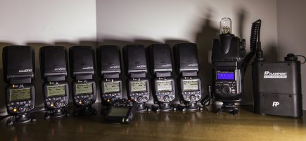

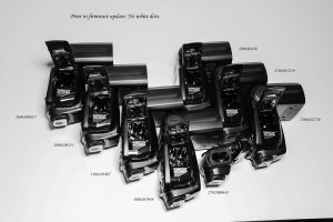

Finally getting around to getting my firmware update done. I called Canon today and now all I have to do is box things up and send them in. I was sent a shipping label via email and they say I will get it all back in 5-7 working days.
Now, I specifically asked whether the updated speedlites would have a white dot after the update. The answer was, "Yes". That would make sense because Canon would be able to tell whether the update had previously taken place without opening a unit up and even quickly be able to let customers know over the phone that the update had already been performed on a particular unit. The updates were performed in factory on units with the affected serial numbers before shipment. Those units got the white dots in factory.
I was specifically asked whether or not I had seven units and whether of not any of them have the white dots. I was also asked whether all the units fell in the serial number range and was asked to read off the serial number of one random unit.
With that all said I am posting a photo of what I have so that all can see there are no white dots. We will wait and see if the updated units are returned with the dots. :)
Update: Everything came back with a white dot except for the transmitter. The dot is just made with a white marker or paint. It ain't purdy like the factory white dots. :)
