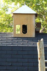

During short daylight winter days I like to shoot birds from a blind set up. Presently, I have only two 600 RTs one a foot or so off camera, cabled and one external where I perceive it is likely to provide fill or frontal lighting of the bird. Midday, fill works but a little later it tends to be all flash.
I was close to another used 600 but wouldn't pay the price he was asking. I've really wondered if I'd be OK with a transmitter and just the two flashes completely away from the camera. The third flash was to have been directed at background lighting of trees.

I have used HSS with success and I guess the biggest frustration is not having multi-fps. I've posted this shot before but you may not have seen it, it's with fill flash and illustrates the landscape I've got.
On the shed, If you look closely you'll see the camera on a gimbal facing out the opposite direction. The door on the right is another option for shooting. I have one way mirror for viewing ease
Jack
