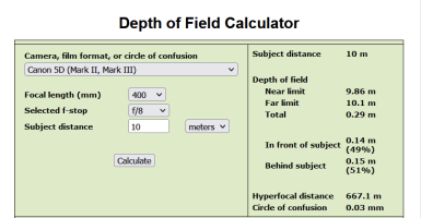

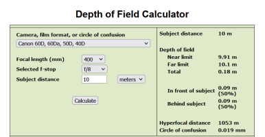

Looking at calculations below from https://dofmaster.com/dofjs.html , the DOF is identical when a 400mm lens is at 0.29m (0.14m in front and 0.15m behind the subject) when FF is at f/8 and APSC is at f/12.7 (FF aperture x 1.6)
What happens if the aperture remains at f/8 on APSC? Your DOF drops from 0.29m to 0.18m (0.09m in front and 0.0.09 m behind the subject), which is 1/3 less in either direction.

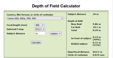

If your want to do an apples-for-apples comparison, to compare equivalent parameters, and achieve the same DOF, you need to change the aperture with the APSC sensor, otherwise we're comparing two images with very different DOF!

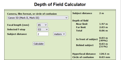

To take the same image (identical FOV, subject size and DOF) when using an 85mm portrait lens:
  • Using FF, subject is 2m away, aperture is f/2
  • Using APSC, subject must be 3.2m away (much further for same framing), and the aperture needs to be opened up to f/1.2
The APSC sensor does not alter the aperture, you do to achieve the same DOF and subject framing when taking the photo from further away. It's only 'equivalent', when the FF and APSC body are producing the very same photo.
The calculations below show the 85mm lens producing the same DOF of 0.06m, but since different distances are needed, different apertures are aslo.
