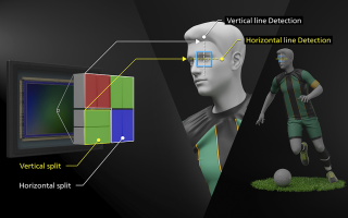

It's wonderful that the R1 has rotated half of the green pixel elements so it can detect both angles (since green has 2 pixel elements in order to fill a simple Bayer square of 4 pixel elements). I wish they had it on the R5m2, but I knew they didn't and I still preferred the R5m2 over the R1 for my particular (non-pro) usage case. I think we can look forward to more of these cross-green sensors in future cameras.

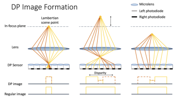

But, I never did truly understand the mechanism (in complete detail!) how the split-pixel idea works to reliably detect focus distance with such a vanishingly small (~2 micron) distance between the center of the pixel element halves. How does it generate a phase difference of the light between each half and how does the front/back focal distance affect it? If anyone knows of a fully detailed article on this then please let me know.
I did wonder about that, since Richard stated it but his diagrams showing it appear to be homemade (the 'pixels' are not all evenly spaced, for example). I asked him for confirmation but he didn't reply. Turns out that's exactly the way it is done, even though I haven't seen a patent for that published (Canon has published cross-type AF as alternating orientations of row pairs of DPAF pixels, and as every pixel with QPAF).
But this diagram from Canon Asia is clear. I wonder why Richard didn't use it?
This is such a simple (in concept) design to add to the standard Bayer array, that I think it's brilliant that they actually have it in the hands of those with the R1 (like you, I think, Neuro). Enjoy! While the rest of us jabber about what Canon should come out with, you get to strut away down the street with your R1 with 6 million (sorely needed) perpendicular DPAF pixel elements with Dual-Axis-Focus, and the BeeGees singing "Staying InFocus!". :LOL:
I don't know either. Is it that each paired split pixel is paired with another split pixel a distance away so that one half of a pixel does the the phase detection with one half of the distant pixel?
The answer is that it depends. Canon states, "The camera's processor compares the signals from the two photodiodes, and if they match, it knows that this area of the image is in focus. If there is any deviation between them, it looks at pairs of photodiodes across a group of pixels, and can then calculate which direction the lens needs to be adjusted to achieve sharp focus, and how much focus adjustment is required."
So the question is, what is the separation for that 'group of pixels'? The easiest way to think of it is that the greater distance the object is away from the current focal plane (wherever the lens happens to be focused when AF starts), the further separated the split pixels need to be to determine the phase difference. For an object on the focal plane, there is no phase difference. I haven't seen Canon explain this, but this diagram from an academic publication (where the goal was to take what amounts to a DP RAW image and create a full defocus map to generate an all-in-focus image) helps:

I looked at the 2 videos mentioned. The diagram for the path of light in the first was incorrectly drawn as it showed 2 light paths in the same direction and position being bent drastically in 2 different directions by the same micro lens. Since we're not talking about chromatic aberration, this can't be correct. The rest is hand waving and exactly what I'm not looking for. But I do thank you for showing links with us that could be checked out.
Thanks for this image. It does give a simple idea of what they're trying to do. But the programmer in me wants to see a lot more detail regarding how things are built and real world test examples. One question this brings to me is whether each pixel "bin" is separated from the others by a sort of wall, and if so adding this level of lensing would cause much of the light in a real image to be blocked instead of reaching the sensor area and thus I would expect a large loss of light being sensed. If there is no wall blocking, then there would be a lot of smearing of light between neighboring pixel elements, and I'd like to see some actual graphs of how a single point source of light (only) in sensed by a line of dual pixels. So I would expect to see some loss of light being sensed as well as some loss of contrast and resolution.
But this image doesn't show how "phase" is affected, as it shows how the direction of light on left/right of the main camera lens is sensed by an array. Phase sensing is where 2 versions (one delayed in time/travel more than the other) of the same signal are combined and sensed at the same point so that one maximum interferes with the other minimum and thus the signal is cancelled, and it is the amount of cancellation that is sensed. Maybe "phase" isn't really what is being detected and another word is more appropriate?
Of course, we know that it does work, so that's not the issue. I'm just interested in the details which go beyond simple images like this. But it is a good start and is similar to what I've seen in the past which does say how a line of pixels have to work together to get a result.

It’s not a guess, it's optics. In-focus subjects have no phase difference, out-of-focus subjects do, and that difference is proportional to the magnitude of the defocus. The phase difference is a vector quantity – it has magnitude and direction, so the AF system can calculate how far and in which direction to move the focal plane. That’s the fundamental principle of phase detect AF.
In a DSLR, the dedicated AF sensor has lines of pixels to accommodate the spread of the phase difference. In a DPAF sensor, separated pixels are used for the same purpose. The separation is not that large a distance for PDAF (a few pixels apart), in a DSLR AF system there is a secondary image-forming lens in front of the AF sensor that is some distance away, which means greater physical separation of the phases.
