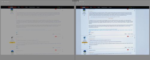

The screenshot below demonstrates what I have been describing. Both CR3s were shot with the exact same settings. They looked identical before I applied a -3.75 adjustment to the Exposure slider to both images. The image on the left shows the typical dull whites you get when there is no data to recover. The image on the right, shot with Highlight Tone Priority engaged, shows how much more data is available to recover. No other adjustments were made to either image.
