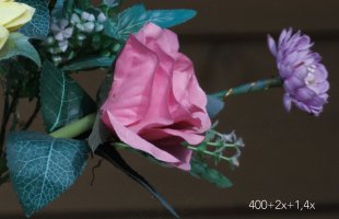

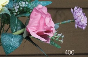

Pictures test:
I took the same flours at the same distance with the same ISO800 and 1/1000
After this i croped the same partial picture
Here's the results :
400mm only
400mm + 1,4x
400mm + 2x
400mm + 2x + 1,4x
