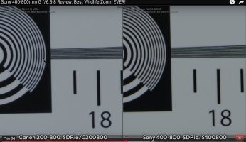

I was looking for a comparison of the sharpness of the RF 200-800mm vs Sony 400-800mm at 800mm and came across this in a short youtube by Tony N. He describes it as being a close tie, but considering that the Sony is on an A1 that has more Mpx than the R5 and doesn't have an AA-filter, the 200-800mm is probably sharper. Here the screenshot from:
with the Canon on the left and Sony on the right.
