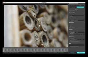

I have to amend that a bit :) While looking at parse_cr3.py to run the 14-bit experiment for @Quarkcharmed I came across https://github.com/dnglab/dnglab. A quick build of that and going outside to make a roll:
Bash:
Mac-Studio:Rolls koen$ dnglab convert --image-index all 20240527\ 1252\ IMG_5014\ Canon\ EOS\ R8\ -\ Canon\ RF\ 100mm\ F2.8L\ MACRO\ IS\ USM\ -\ 0.29\ m\ -\ Mechanical\ Shutter\ -\ RAW\ -\ CSI_5014.CR3 CSI_5014.dng
Writing DNG output file: CSI_5014_0003.dng
Writing DNG output file: CSI_5014_0005.dng
Writing DNG output file: CSI_5014_0007.dng
Writing DNG output file: CSI_5014_0000.dng
Writing DNG output file: CSI_5014_0004.dng
Writing DNG output file: CSI_5014_0002.dng
Writing DNG output file: CSI_5014_0006.dng
Writing DNG output file: CSI_5014_0001.dng
Writing DNG output file: CSI_5014_0015.dng
Writing DNG output file: CSI_5014_0009.dng
Writing DNG output file: CSI_5014_0012.dng
Writing DNG output file: CSI_5014_0013.dng
Writing DNG output file: CSI_5014_0011.dng
Writing DNG output file: CSI_5014_0014.dng
Writing DNG output file: CSI_5014_0010.dng
Writing DNG output file: CSI_5014_0008.dng
Writing DNG output file: CSI_5014_0020.dng
Writing DNG output file: CSI_5014_0022.dng
Writing DNG output file: CSI_5014_0016.dng
Writing DNG output file: CSI_5014_0023.dng
Writing DNG output file: CSI_5014_0019.dng
Writing DNG output file: CSI_5014_0021.dng
Writing DNG output file: CSI_5014_0017.dng
Writing DNG output file: CSI_5014_0018.dng
Converted 24/24 files
Total time: 283.12s
DxO PR4 accepts the resulting DNGs, but it doesn't crop out the sides of the image that are used for e.g. blackpoint calibration. This might be intentional behaviour, you can do all kinds of neat things if you have access to the whole sensor and the software is called dnglab :)
This makes pre-capture slightly less useless for me, but only slightly.
