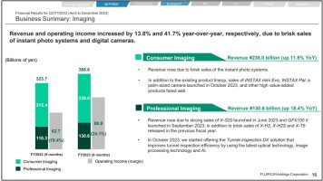

From the financials that Fujifilm released this month.
Yeah, hard to know how those sales are distributed amongst the three models, but the X-H2S has sold pretty darn well from what can be observed. Again, relatively speaking. Fujifilm sells like 5-6% of then entire camera market versus Canon at over 46%, so I'm sure it sells much fewer units than an R6 Mark II, but it has been a success and proof of concept for Fujifilm for sure.
