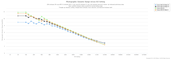

While I was not expecting much of an improvement, if any....and I agree with others assessment that the R5/R5II doesn't mean much....increase in DR is certainly not a reason to upgrade from the R5 to R5 II. If anything....it might be a reason to stay with the R5.
Edit...I do want to say, increased DR is really not needed. I rarely had an issue with the 5DIII, almost never with the 5DIV, and do not with the R5. So an improvement is was not needed, IMO. The R5 and R5 II are industry leading for FF sensors at this level.
Shame about the baked in noise reduction. Honestly, I had hoped that the R5 Mk2 would show improvement over the R5. All those patents but nothing meaningful in any of the new cameras.
The problem with the baked in noise reduction is we have no idea how much of a boost that is giving the R5 or the R5II compared to having no noise reduction baked in. The chart comparisons are not apples to apples as a result.

The R5II seems to have a slightly lower DR than the R5, although it has less hot pixels popping up in long exposures. Also its baked in noise reduction is milder that that of the R5, so the actual physical DR difference before the noise reduction may be less that 0.4 stops.
But overall the R5II basically slightly worse than the R5 - so those who don't care about AI, AF improvements, pre-burst feature and video improvements, may skip the R5II and get an R5, or stay with their R5 if they have it already.
In other words, the R5 looks like a better value for money camera if your primary focus is on landscapes, architecture etc.

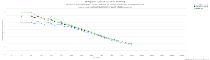

DxOMark puts the actual base ISO of the R5 at 54. That means at the setting of ISO 100, the camera is actually pushing the exposure by nearly a full stop. Most likely the 'baked in' NR is intended to counteract the additional noise from that 1-stop push.
