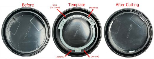

One thing that I absolutely despise about the RF mount is the rear cap design. It is so frustrating to use and you can only mount it correctly one single way. EF rear caps were so much better, they had 3 different angles you could pop them on. Even 4 years later, I still battle with RF rear caps.
If you're not afraid of a doing a little surgery with an XActo knife, you can try this mod:
I did it to a couple of Amazon rear caps and it works great!
EDIT: Same thing that @neuroanatomist posted in post 242, just different pics.
