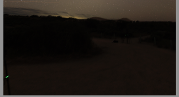

I pulled a 2 minute exposure (ISO800) ie 1 panel of a milky way shoot last year in LR and did a screengrab of the foreground (bottom quarter).
No noise reduction, dark frame or LENR applied. Default profile in LR with no adjustments besides chromatic aberration removal.
Note that it was using an astro tracker so LR might not have removed them automatically because of this.
I counted ~16 hot pixels with most being white. The green ones are most noticeable but the white ones are barely visible even at 100%.
I have ignored other lights from different shooters which are separate to hot pixels.
Note that the foreground is just for horizon alignment as it is replaced with a separate foreground taken during twilight so it a moot issue in this case.
Of course, hot pixels would also be in the sky but I haven't had a situation where they have been noticeable enough to warrant any attention in post.
